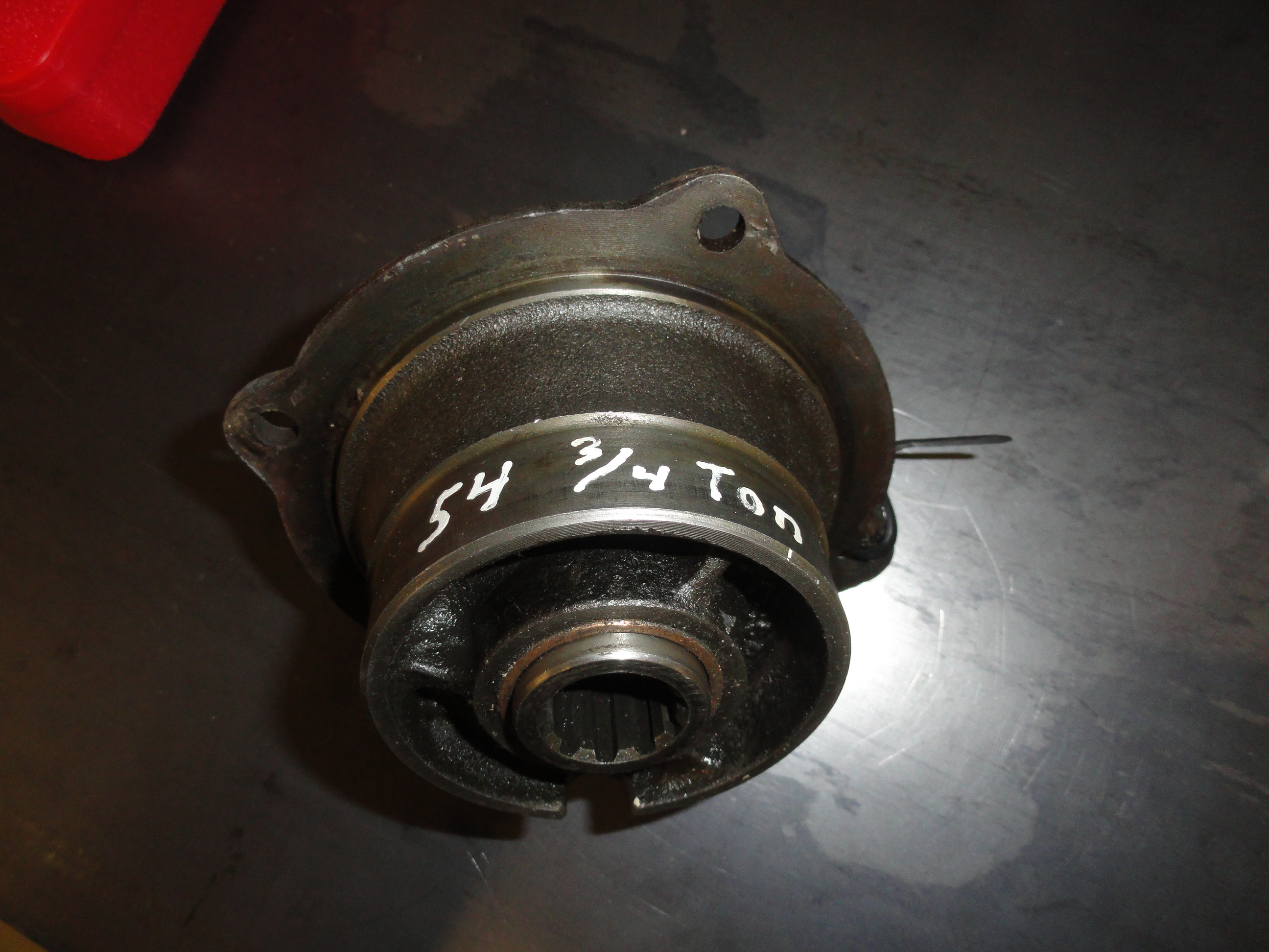

The Transmission, however, is another story. With the Torque Tube gone, you now have to mate the new rear end to the transmission with an Open Driveshaft. I find the 1962 vintage Suburban to have the perfect Driveshaft for cutting down to the proper length. So anyway, we have several options for Transmissions, but I am betting you didn't know that you could keep your old one? In 1954, an adapter was produced by GM to accommodate the use of the old Torque Tube style Transmission with the new Open Driveline. It was available on 3/4 ton trucks and is very rare. Finding one of these puppies is going to be the hard part, but the design seems very sound. The old transmissions were work horses and very seldom require repair, so this is something that if you can find one, it's not a bad choice.
Simply remove the lock pin and unbolt the center retaining bolt and this Adapter bolts right in place. Re-Install the Lock Pin and it's that simple! Now you are not looking for shifter parts, or cutting up your floor to accommodate the new shifter location, or any of that. These Adapters are hard to find, but sometimes it's nice to be armed with knowledge of simple solutions before getting out the checkbook! Special Thanks to Pre68Dave yet again! Seeya Next Week!
