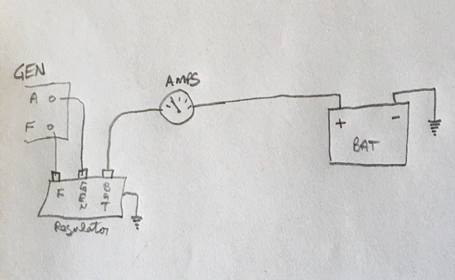

      Thanks Deve. I have another question.
      I am going to keep the generator on my 235 engine just to keep it stock. I have the generator mounted on the engine on the test stand with the regulator connected. Will you please review my attached sketch of how I have it wired and comment? The original wiring diagrams for this 1955 235 engine are a little confusing to me but after deciphering them, this is how I have it wired. I followed your test stand control panel design sketch, but substituted a generator for the alternator you used in the sketch.

      • #4
        That looks right to me. I do not know much about generator/regulator operation. I immediately go to an alternator because it uncomplicates the system. I do appreciate keeping things stock though!
