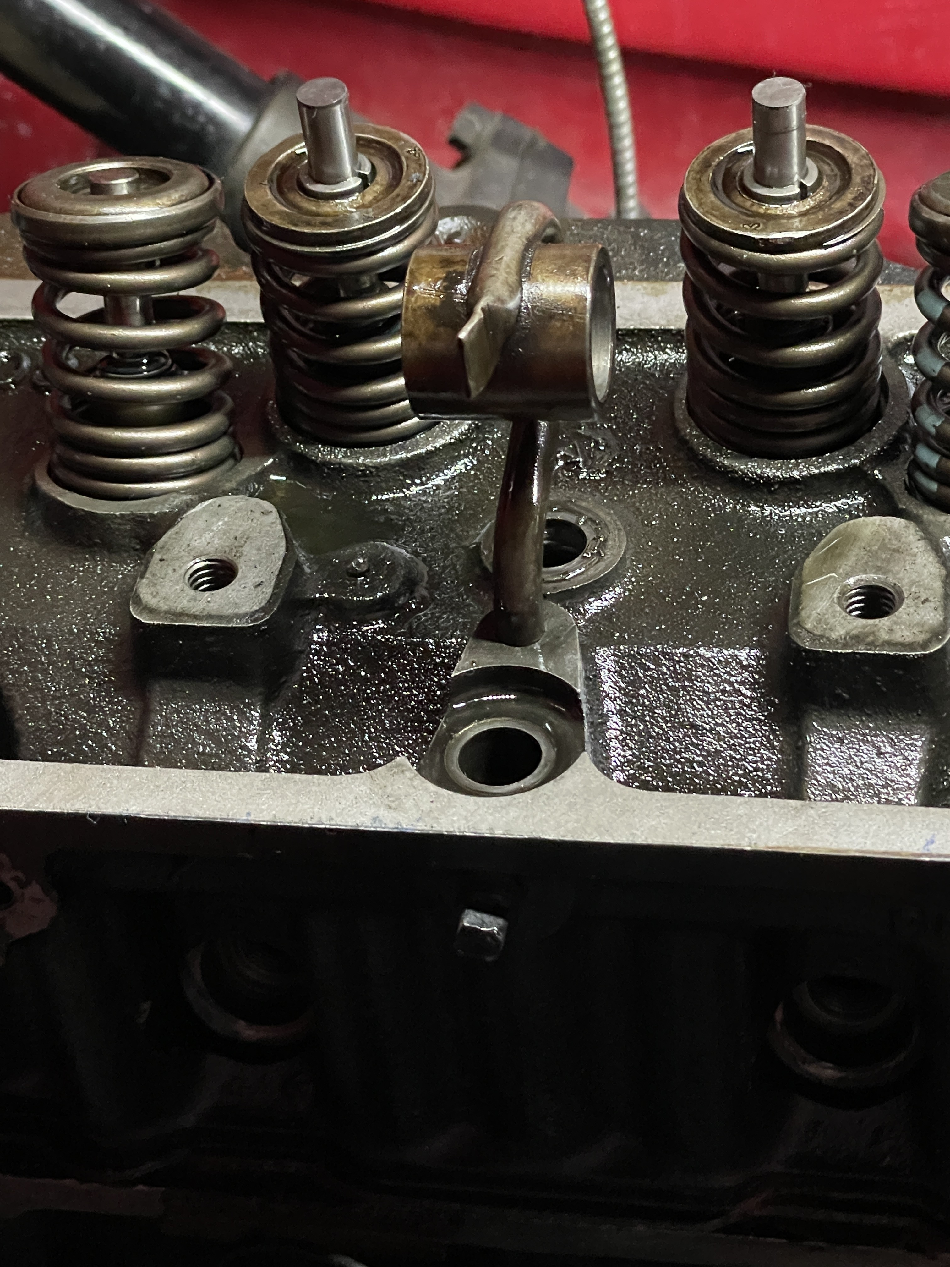

    I would just keep the head gasket in tact so you can compare the new one to the old one. Always a good idea. Also, there may be a special bolt with a hole in the center that should go back in the place it was taken out of. The bolt would be the one nearest the brass loop in the center of the rocker train.

        So the center bolt, #2 according the Chevy's bolt pattern, is one of the long bolts and the #2 did not have a hole. The weep tube I guess it is, does have a direct connection into the head for oiling... so I'm assuming this is normal. As someone in the past did a rework on the engine though, if they screwed up and didn't put the right bolt back, would be good to know.

                The hollow bolt may not be necessary for that engine. Always prime the oil pump after the rebuild to make sure there is oil getting to the rockers. To understand the oiling on that engine, read this article carefully:
                That will help you understand why the larger lines are needed. That is a solid lifter engine so the lifters all need to be the same height and so must the rods. You can put hydraulic lifters in that engine without problems but you have to decide which. The 848 head was never on the 261. The 261 came with an 850 head. If you have an 848 it has to have those holes drilled in it per that article. If the engine had the 848 head when you got it, chances are they are already drilled, but good idea to check.
