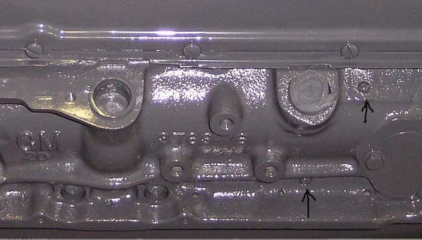

      Click image for larger version

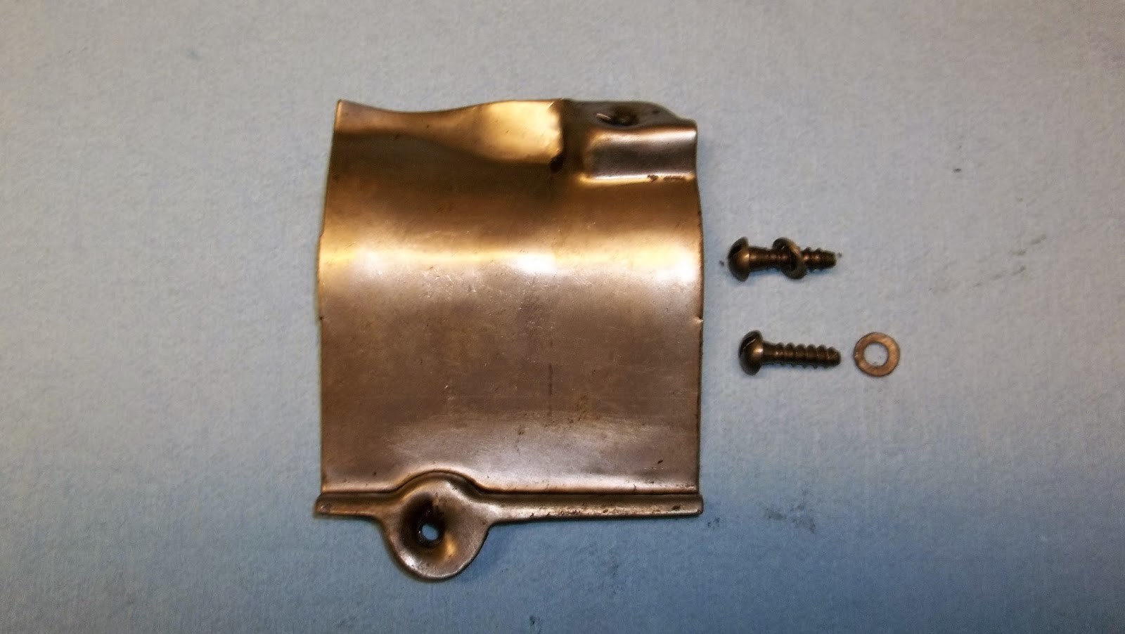

ID:	4016 All the baffles I have seen are held on by two screws. See picture

      • #4
        Yeah, that's my experience too Dave. Simple sheet metal screws. Hope life is treating you well!
          Picture of baffle.
          All is well here Deve!
