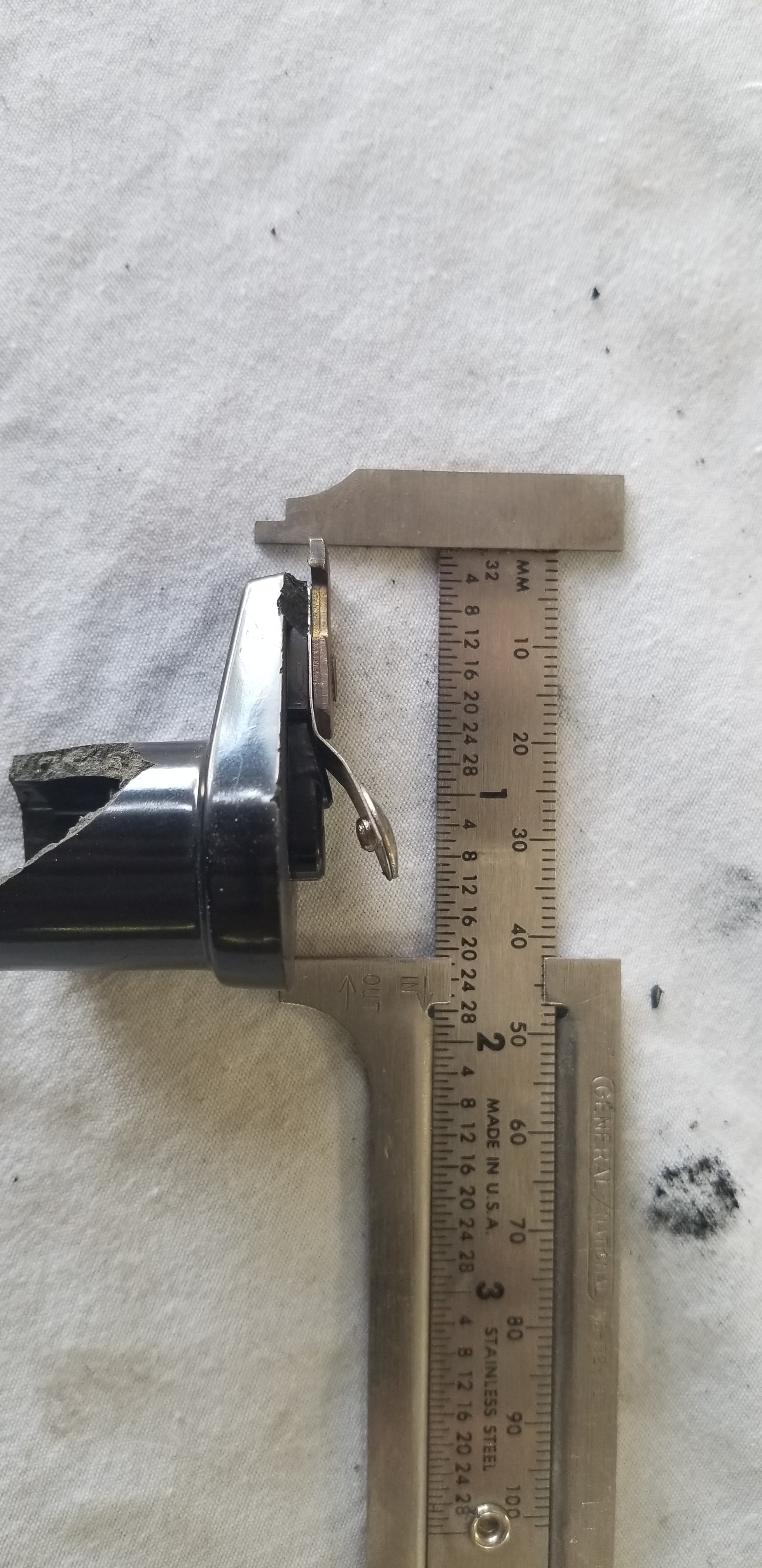

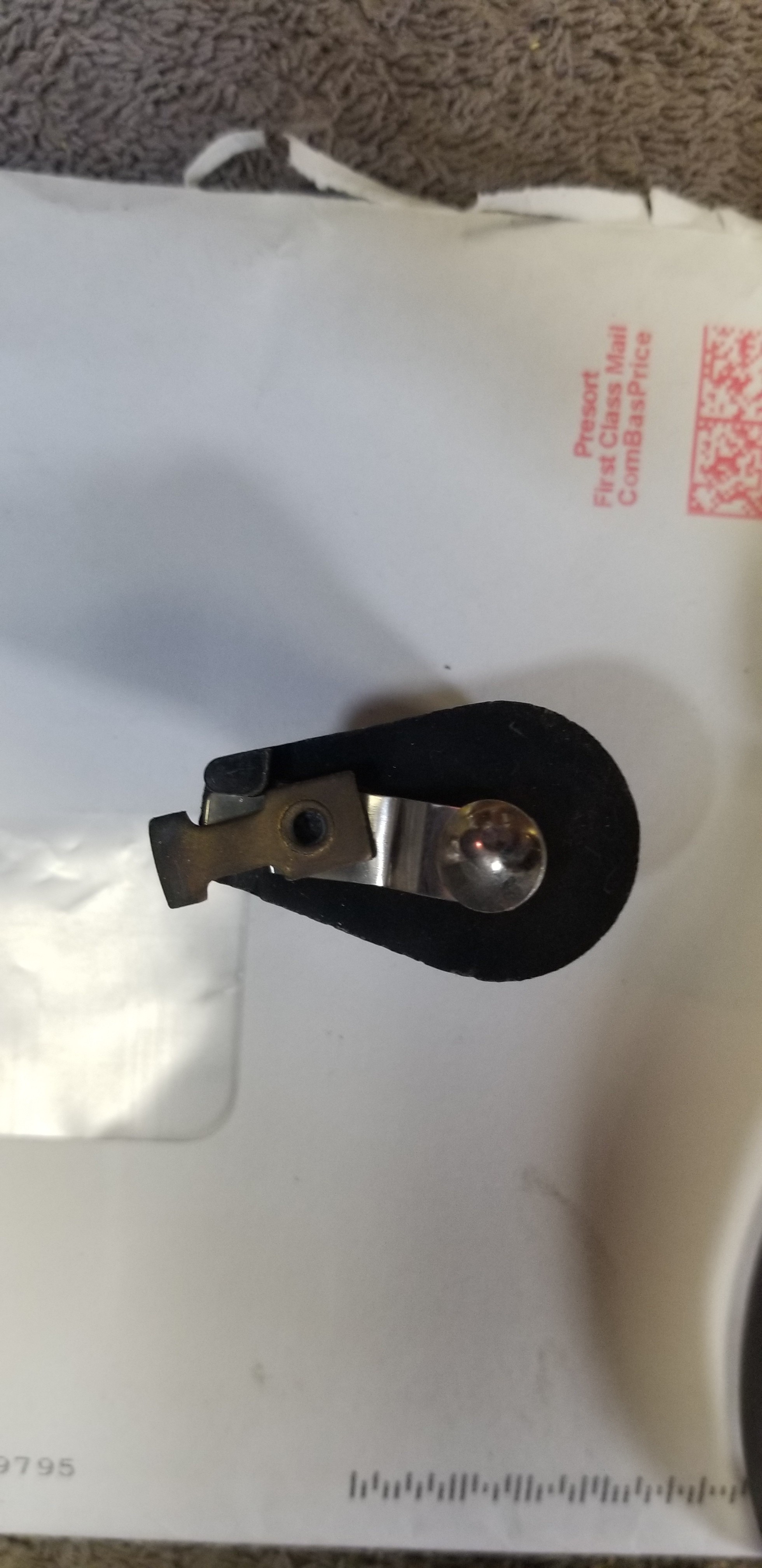

            My 261 had a little miss so I pulled the cap and found this ... a broken rotor would anyone have a part number for this rotor ? NAPA ...O'Reilly's...where? EBAY ?
            THANKS !!
            Dan

            • #7
              Though I Click image for larger version
ID:	3556Click image for larger version
ID:	3557 added picture???
              Comment
              • #8
                Sure thing. It's a Standard Motor Products DR308. I get them at rockauto.com. https://www.rockauto.com/en/moreinfo...25944&jsn=2201
